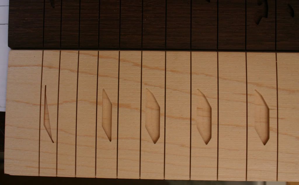

I gather all JEM Vine and Pyramid Fretboards are quarter-sawn.
Got some totally Flatsawn ones from a seller (MonsterGuitarShop) and the fibres at top frets looks too flimsy, making durability questionable.
Does anyone know if this Flatsawn surface Will affect durability?
The strings would just shave off the wood, probably.
I expect that Quartersawn would have a more 'rigid' surface here.
The second
Rosewood board
in the top image is from another seller. More details here:
http://www.jemsite.com/forums/showthread.php?t=70490
Quartersawn though.
The Pyramid Maple Board has some faults with the routing at 24ft:
Anyone knows more on flatsawn V/S Quartersawn regarding surface durability?

Re: Vine Boards Quartersawn ? - Durability issue
In general, I wouldn't have any problem using flatsawn wood for a fingerboard. It really comes down to the individual piece of wood. Rosewood is usually pretty durable. I suggest you first sand it down to a nice smooth surface and then re-evaluate it. The strings shouldn't wear directly on the wood that much, especially at those
high frets
. Then again, you could have a particularly troublesome piece. Can you pick fibers up with a fingernail? Without seeing it, my guess is that it would be fine. But if you have doubts then get a different board.

There are some -2- unnecessary extensions of the routing on the 24th fret.
Does a real JEM PYRAMID neck have those?
Does anyone have a High Res. Picture of the 24th fret to clarify this?

05-19-2008, 07:30 PM
ryanb
Location: Detroit, MI, USA
Posts: 1,457 - iTrader: (
If you want to make it look better, cut back the top edge of that inlay route so it meets the over-routed corners (or at least is closer). You could make it pretty well disappear. (That assumes the inlay itself is either already oversized or you can make a bigger one.) Otherwise you could fill the corners with a lacquer fill stick. It won't match perfectly, but it won't be too noticeable.
Almost every Fender
Maple neck
is flatsawn, so I wouldn't get overly hung up about Flatsawn Vs Quartersawn - in fact Musikraft state that Quartersawn Maple can actually be too stiff, rendering the truss rod non-functional with lighter
gauge strings

David McCarroll
... Musikraft state that Quartersawn Maple can actually be too stiff, rendering the
truss rod
non-functional with lighter gauge strings.
I have not seen any Factory JEM or UV Maple Fretboard with anything but Quartersawn fibres.
