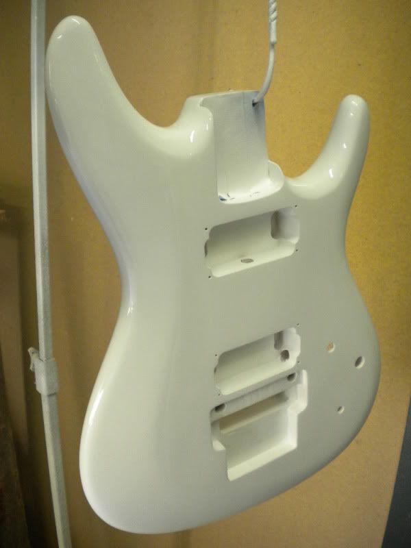

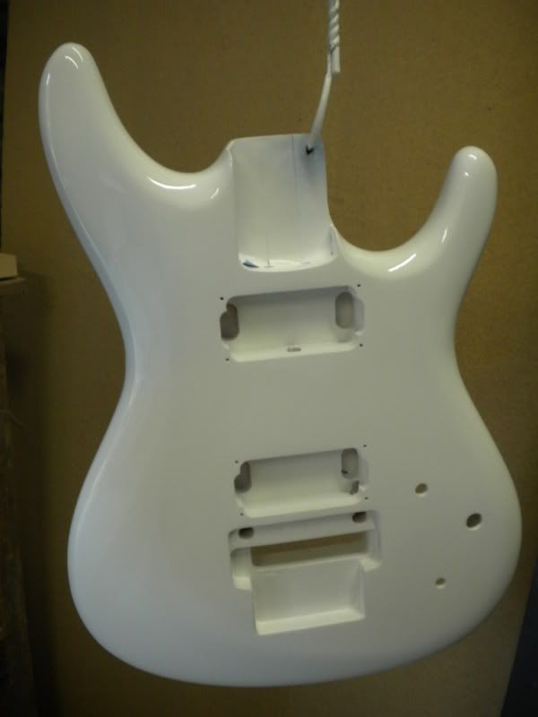

Old 08-06-2010, 04:43 AM
SP2333  is offline
Join Date: Dec 2008
Location: Sydney Australia
Posts: 268  -  iTrader: (0)
Re: My JS White Project...
I was able to find some correct neoprene rubber sponge that goes into the trem cavity today.. When the body gets back from painting ill cut and stick it in...
  #28
Old 08-09-2010, 02:05 AM
SP2333  is offline
Join Date: Dec 2008
I got some progress pics of the painting of the body today....
Looks like Ernie from ET guitars is doing a great job for me.. He is working on the clear coats...
Im super excited now to see it. Cant wait... WOOOOOT..
