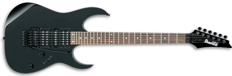

'07-'11 GRG270B.......... the neck looks original, someone sanded the headstock to hide the fact that it's a GIO.

I'll go with RG370 like the first guy suggested. I doubt that is a Japan body and hardware. Early to mid 2000's era Korean made when they were using the Edge pro II. 95 percent sure.
The Gio idea I guess works but I don't think they ever used the Edge Pro II on any Gio. At least none that were in the US market. Maybe abroad? Or I've got the timeline wrong when they started using the 3's even on the Gio line ups. I was always under the assumption they went from the @#$% Lo TRS IIs straight to the Edge 3's on those. I might be wrong.
