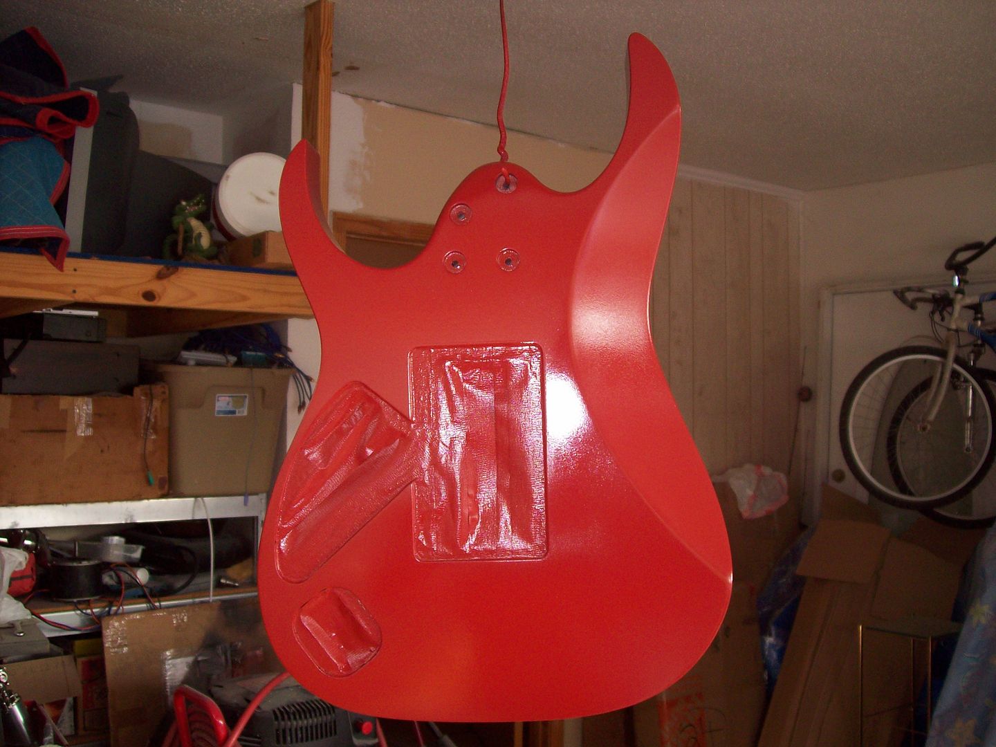

Now on to one of my favorite projects yet. This started out as a mild mannered RG520 with the matte Iron Pewter finish in basswood. I thought I had more pics of the beginning of this but I can't seem to find them. Nothing anyone hasn't seen before, just alot of sanding, and priming.
Then I took the file for the graphic to a local shop and had them make it with the same material they make the vehicle wraps with. I got a graphic for the body and for the headstock. Here is said graphic.
The next step was to go to automotive paint store and have them color match the deep blood red in the graphic. The paint I got has some pearl in it as well, so its really hot in person. Didn't show up to well in the photos however.
Now I made a template from the guitar body so I could make sure I get the placement of the graphic correct.
Then it was on to shooting the base color and a few coats of clear.

Then it went back to the garage, I had to shoot a little more color to make sure the edges blended and I fixed a few little nicks I made with the exacto knife when I mounted the graphic. Then a full can of clear for the top and top edges, then another can of clear for the entire body. Then the waiting for the clear to cure enough to sand and polish. Finally get to start putting her together.
