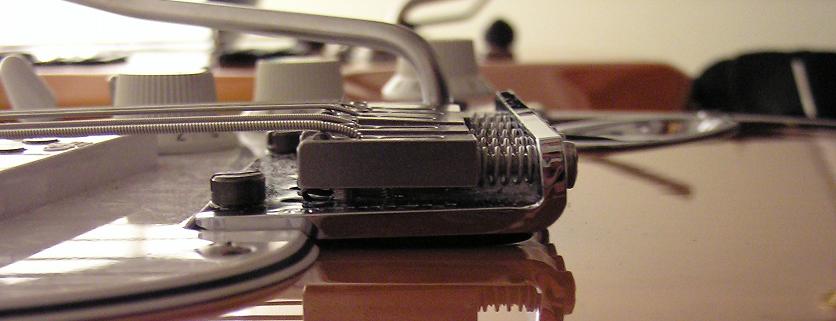

Try it off the body a little. I have a
vintage trem
on mine and I can pull up lots the way I have it setup.

Here's a pic of how mine's setup:
