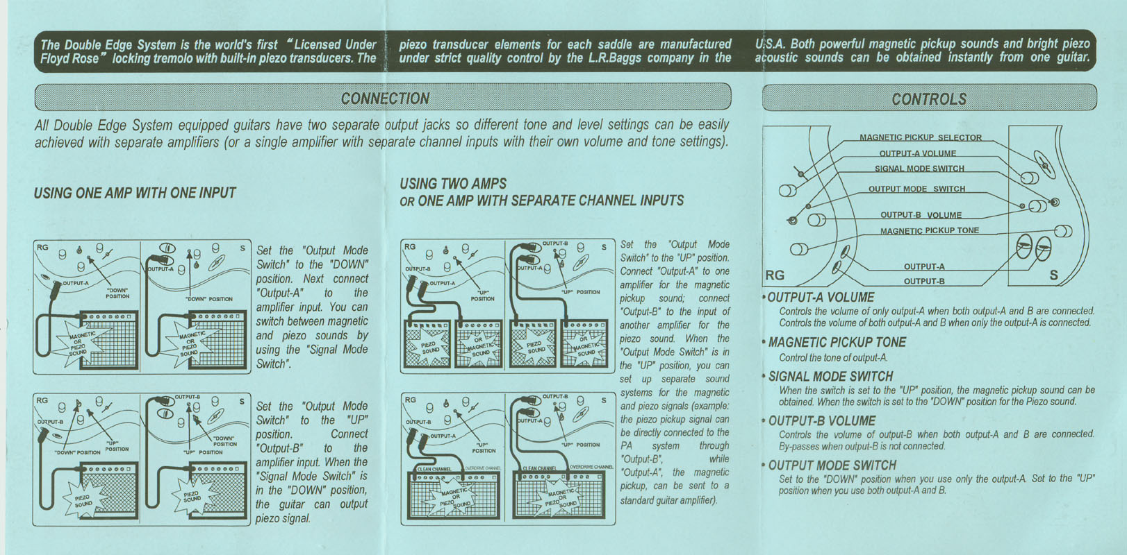

Or you could just use this
http://www.ibanezrules.com/catalogs/...0_controls.jpg
bridge hum, bridge humbucker, neck humbucker
