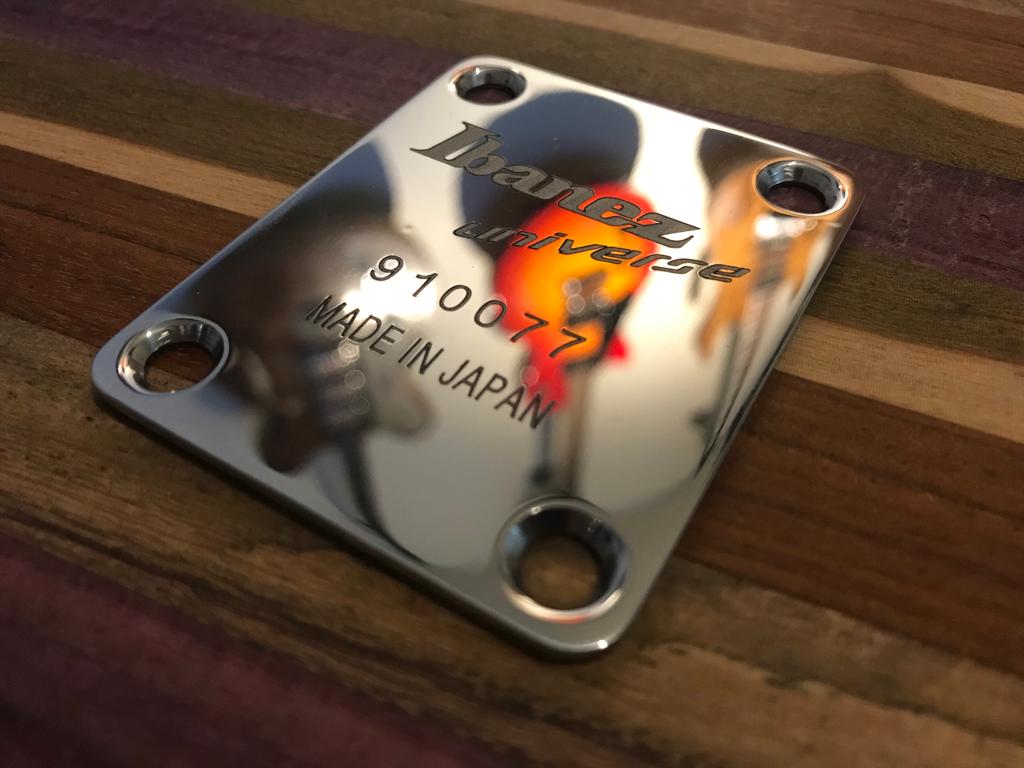

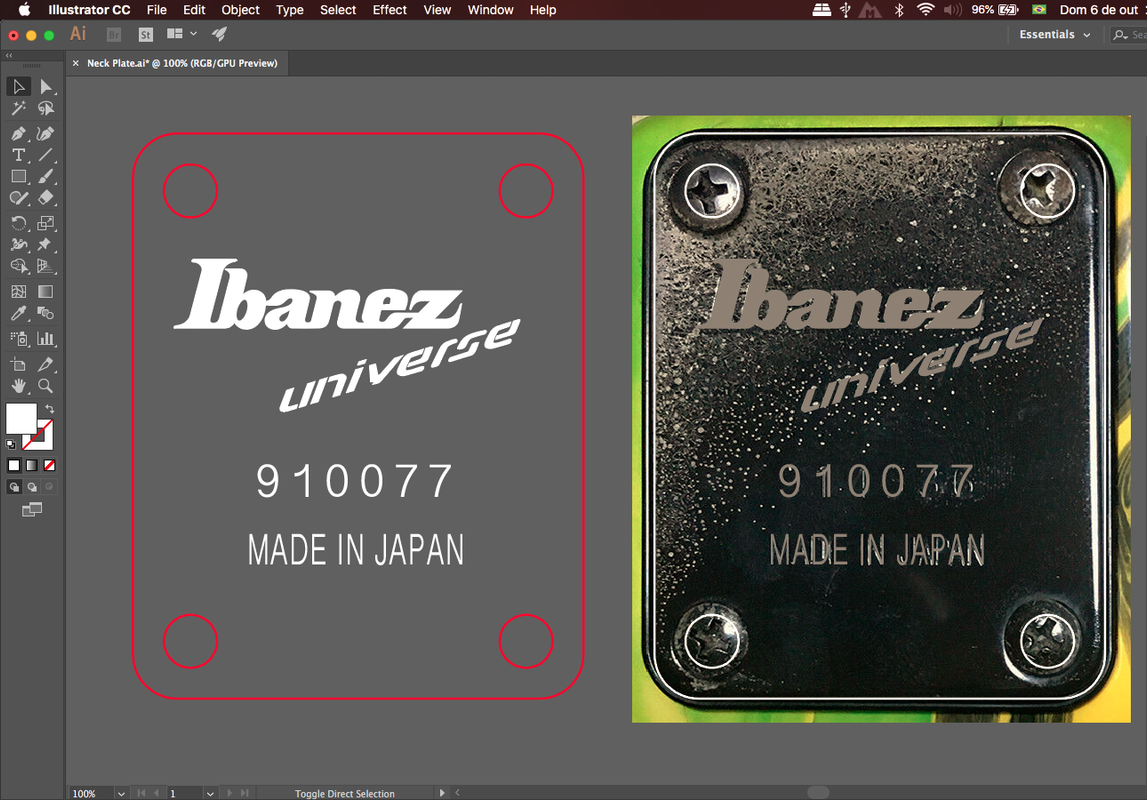

When the neck was completed, I was in need of a neck plate and obviously, couldn`t find it anywhere in planet earth, so I decided to make my own plate.
Did the vector and asked Rodrigo “Ramme Customs” to build one from scratch, laser-cut.
The serial number is random, just a number I choose.

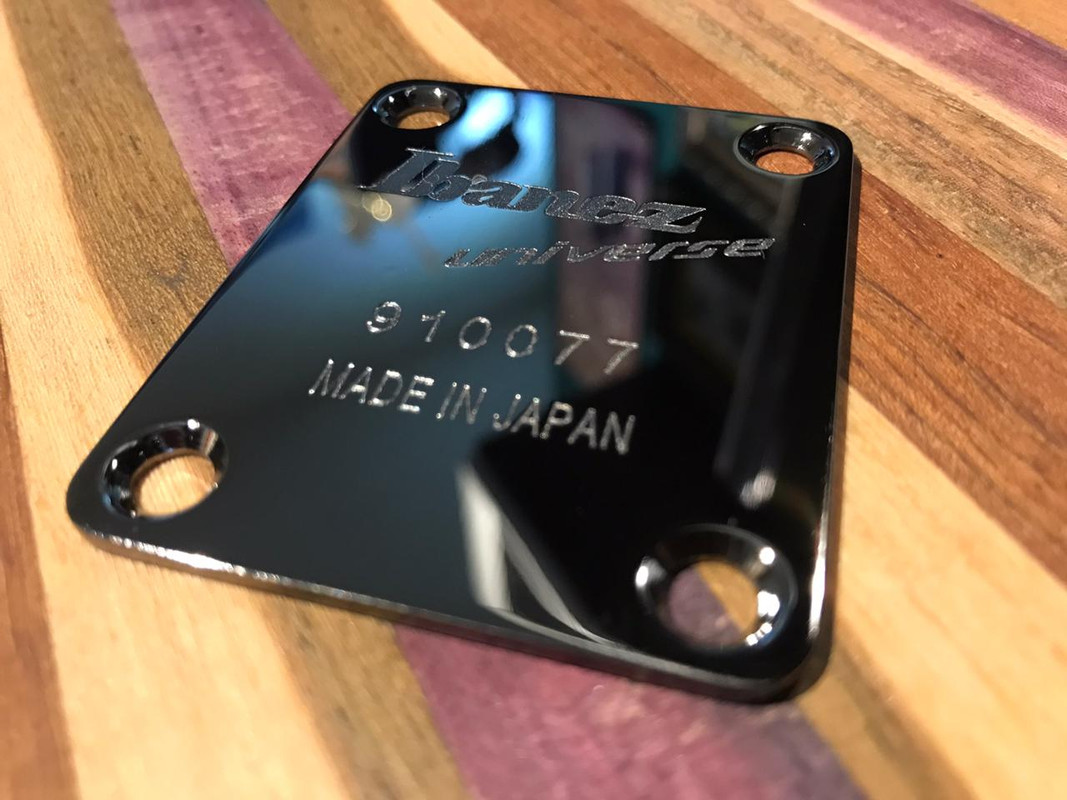

The results:
Raw material stainless steel
Cosmo Black layer.
