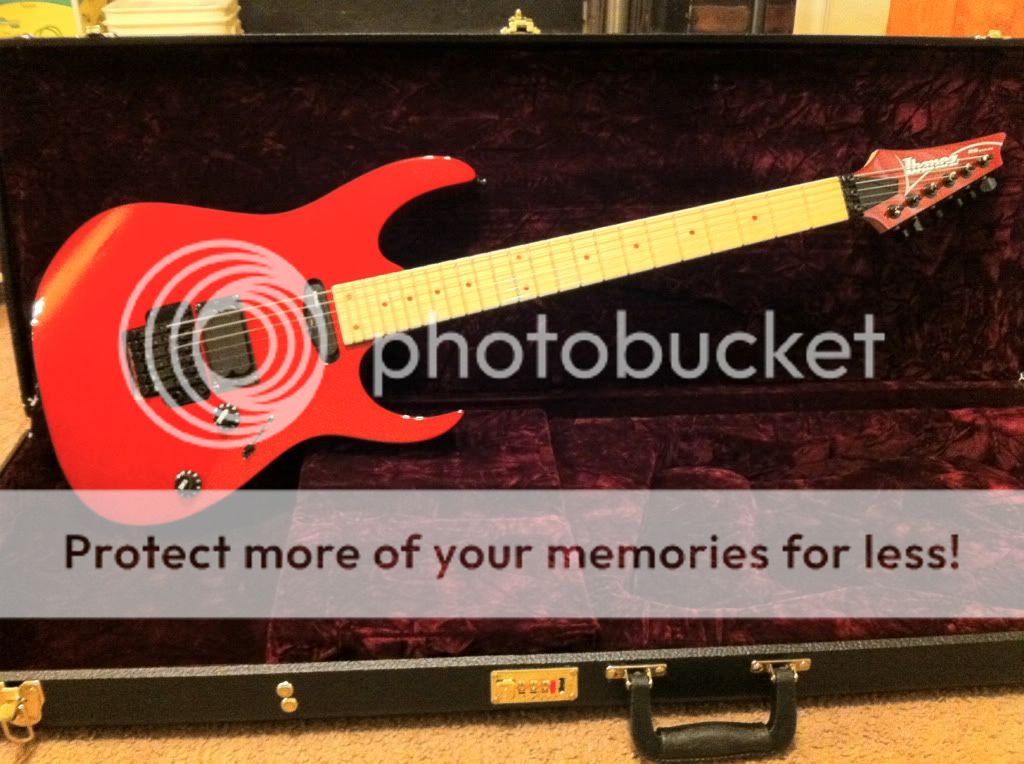

All the recent talk about these things had compelled me to grab one, so that being said, here's a crappy cell phone pic :

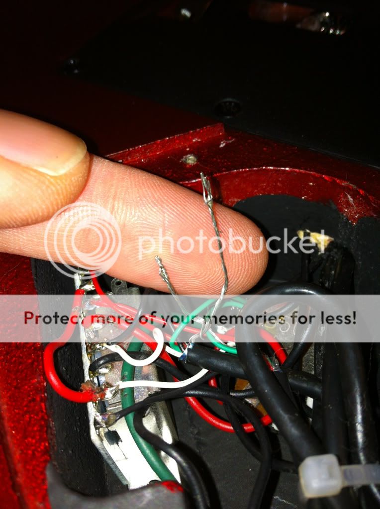

Most of the QC issues with these discussed elsewhere on the board are present on this guitar, to some extent. They're all minor, and most can be easily corrected (and most have been already since I got her). The most baffling issue I found was this:
I had originally opened the cavity to look at what pots/switch they had used, and saw that pretty little sight. What's confusing to me (and a Dimarzio tech that I talked to), is that this is causing NO issues. Switching works as advertised, no noise, no hum, nothing. It just works like it should. It's a head scratcher, for sure.
Overall, this thing is pretty cool, and will fit it's purpose of being a gigging axe nicely. The Edge Zero II is nice. I removed the ZPS bar, and fully floating, it works like a champ. Definitely light years away from the Edge III quality wise. I was cautiously optimistic about the Deactivator in the bridge, because I'm normally a PAF guy, but it sounds good, and will fit nicely in my arsenal. The Wizard III neck is nice, too. It doesn't have that "big shouldered and chunky" feel of the Wizard II. On top of all that, and most important, it just looks awesome....

Damn, those solder joints on the selector switch look terrible!!!!
Pretty guitar tho!

Talk about QC issues!!!!! The hot for the neck pickup is cooked so bad the wire is exposed!!!! Same thing with the jumper.............that's sad.
Killer collection jski!!! hope you get this RG3 sorted out.............
BTW...the bare wires don't HAVE to be soldered to ground if the green wires are....it's just better if they are.

Thanks guys. I plan on cleaning up the wiring, and cleaning up the neck pocket soon. The neck is higher on the bass side, so I'm going to pull it off and see what's up. I fully expect it to be a "paint-in-the-pocket" issue. Just thinking how sad it is nowadays that I expect to have to do work on any lower-end Ibby to get it "right", outside of the normal setup.
