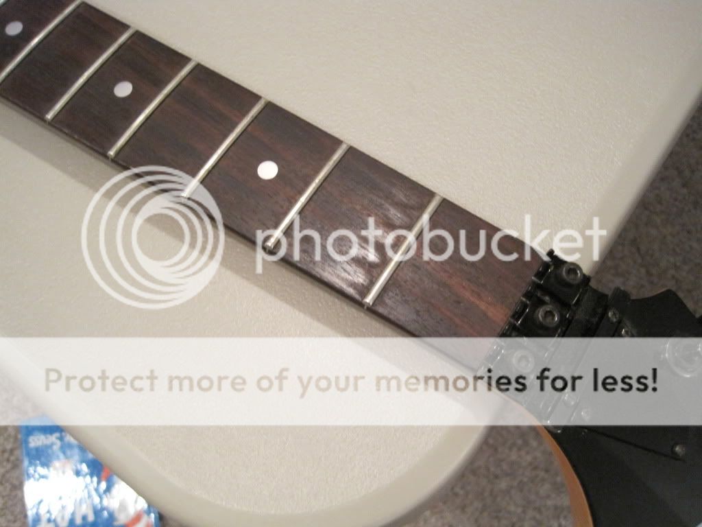

Obviously this neck was off before as someone before me put the plate on backwards. I also thought the screws were in the wrong holes. Hopefullly something I won't have to fix later.
Well Learned something already. This is a RG560 guitar and the neck is stamped 550. I am assuming either all 560's are stamped 550 or this neck was replaced at some point.

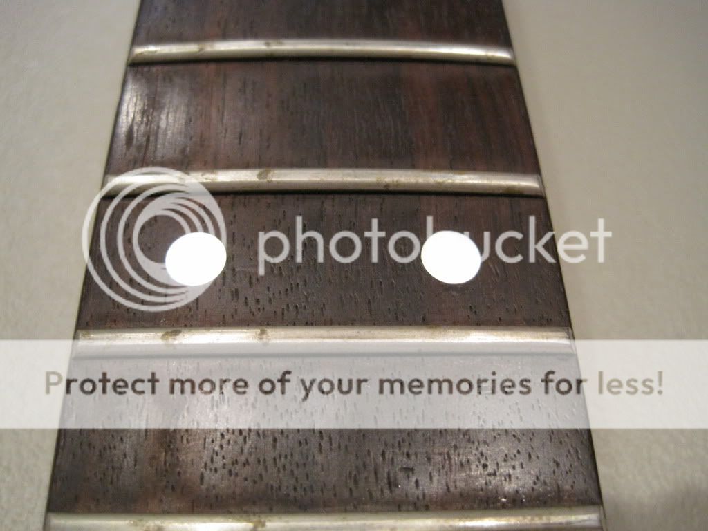

I took the edge of a guitar pick and held it fairly flat against the fretboard and scraped off (always with the grain) what I could of the crud. Sorry I forgot to take pictures of this but here are a couple of the dirty looking frets and fretboard. yucky...

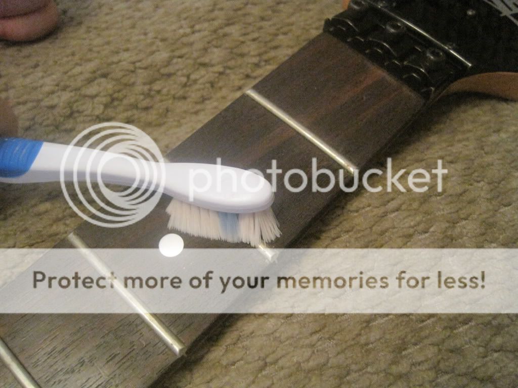

I took a toothbrush and quickly brushed (with the grain) the entire length of the board to brush away any loose material and to help loosen whatever else is on there. 9 out of 10 dentist prefer oral B you know.
