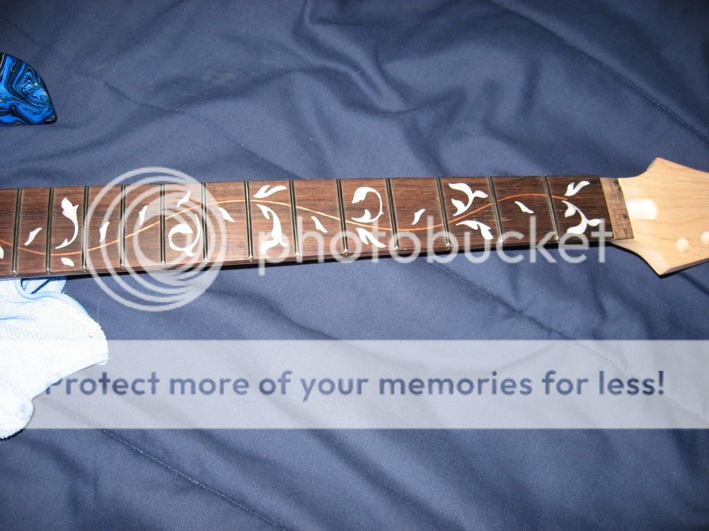

It has begun! Big thanks to Dgbaker and Jaden Rose on the amazing body/neck for this project. I have a few questions, but here are some pics first!(sorry for the bad pics, too cloudy outside right now and it looks like its about to storm)
These pics do no justice to the body or the neck. I currently have a Lo-Pro Edge on order from Rich in black. I plan to use black tuners and hardware with this project. Now on to my questions. First, what pick-ups would you all suggest? I am thinking Evo's, as I want to stay with DiMarzio. Also, should I paint the headstock black with a matching blue Ibanez logo, OR have Dave swirl it to match with probably a white or mirror silver ibanez logo?
Lastly I will show you this pic. Is the neck sitting too high here? If so what would be a good solution to fix this. Sorry for blurriness.

I would use a belt sander and shave a bit off the back of the neck joint area. It has to be totally flat to make a good connection with the body, and deepening the pocket is not recommended. It might look high initially, but i would wait untill the trem is in, and strings are on to determine if its high.

Just used a block sander and took the slightest bit off of the neck. Along with that there was some paint that had moved into the neck joint area while it was painted and had a bit of build up that was keeping the neck from sitting completely into the joint. Once I had that all cleaned up it sits much nicer.
Yes, it is too high. The reason why is because dgbaker is using Legacy One bodies. The dimensions are all screwed up on their routing. Don't ask me how you can make this mistake when the dimensions are very clearly published? If you measure the neck pocket, you'll find that it's routed only 16mm deep. The correct dimension is 19mm (technically there should be a slight taper). Similarly, the pickup routes and trem route are too shallow. Also, he skips the hand sanding that is necessary on the AANJ to make it smooth.
The only solution is to get the neck pocket routed correctly. That may leave you with an issue where the trem then sits too high, meaning you would have to get that routed correctly as well. At that point, you'd probably just want to paint out the trem cavity black.

The 3 other bodies i have here have between 17 and 18 mm pockets. If your talking 1 or 2 mm, you dont have to re route the neck pocket. If anything, you would shave off a mm on the neck like i suggested. Since were talking about both an aftermarket neck and body, there are always tweaks involved in the process. The only solution is NOT having the neck pocket re routed...

I've taken a ruler and measured a Legacy One body against an RG3120 and RG8520. The two real Ibanez bodies had the same dimensions, which coincidentally conformed identically with the published Jem specs. The neck pocket on the Legacy One body was 3mm too short, which will cause the neck to sit up just like in this thread. Take a look at a bunch of the other recent build threads since Legacy One bodies have become commonplace, you'll see the same thing.

I just measured the pocket on my RG570 and its 18mm.
I dont want to get into a big post war here, but if were talking a 1mm difference, the best solution would be to sand a bit off the back of the neck. Correct?
I dont know what the thickness is of the neck either. It MAY be 1mm to thick?
I understand that you have an issue with Legacy(along with some people here, myself included previously) but thats not going to build this particular guitar.
I really think that saying re routing the neck pocket, trem cavity, and then repainting that cavity is the only solution, is way off the mark.

Ok everyone calm down. I did take a ruler myself and checked the dimensions with another JEM body that I have along with another RG body of mine. The trem cavity was dead on accurate. I then measured the routing for the pickups, which were also dead on. I measured the neck pocket and it sat 1.5mm high. This is not worth a reroute. I simply had to sand down my neck that 1.5mm and everything was fine. I did not take the time to check my other wizard neck, but as Dave says, it could EASILY be 1-2mm thick, along with the body, therefore making it look that high. I simply took a belt sander to the neck, and it sits perfectly now. If i ever use the neck on another body, it is quite easy to shim. You'll always find a small bump in the road on a custom project, and this is mine. It took me 5 minutes to correct.

I just don't like the idea of sanding the neck, that's all. That was why I suggested routing the neck cavity. I just remeasured my body and the trem route is probably fine. The reason I suggested rereouting the neck pocket is that it's unfinished in there anyways. It could simply be resealed afterwards.
For basis of comparison, I took some measurements of two guitars and a Legacy One body. Just putting this out there so that other people check this out for themselves:
2003 RG8520:
- neck cavity 19mm
- pickup routes 22mm
- front of trem cavity by mounting studs 6.5mm
- rear of trem cavity 18mm
2001 RG3120:
- same as RG8520 except 5.5mm at front of trem cavity
Legacy One body:
- neck cavity 16mm
- pickup routes 17mm
- front of trem cavity 5.5mm
- rear of trem cavity 11.5mm (no claw in this body so can't meaure that)
Published specs:
http://static.keebali.com/jemsite.com/jem/origin/jem777_blueprint.jpg
- neck cavity 18.9mm rear/19.4mm front (you can see this taper on a production guitar with the neck mounted)
- pickup routes 18mm center with 30mm pockets on the sides
- front of trem cavity 5mm
- step in trem cavity 12mm
- claw depth 16mm
The trem mount looks like it's probably fine. The pickup routes, while not correct exactly, realisticaly make no difference (my guitars with 22mm routes need blocks of foam under the pups). It's the neck pocket that's way off. Judging by pictures and my ruler, I'd say 3mm looks right. If that guy actually responds to anyone, maybe they can get him to correct his code for his mill. Maybe I could even get him to correct my body and put in the jack hole he so conveniently left out.
