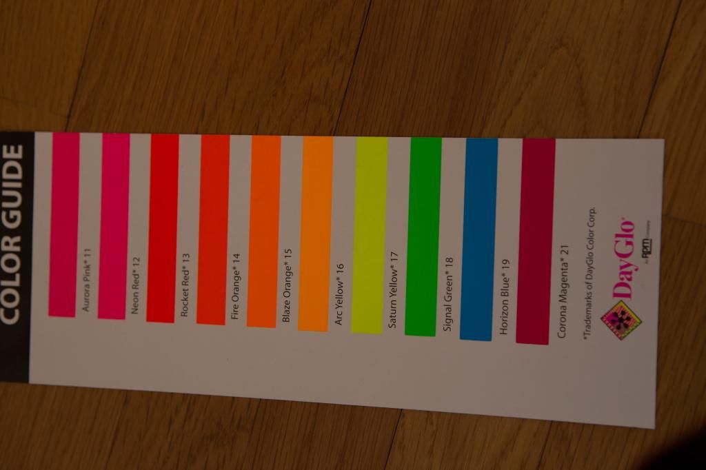

Here are some pictures, on the left is the RG 20th anniversay and on the right is an original '87 RFR RG550
Desert Sun Yellow --
MY KIDS TOY THAT HAPPENED TO BE RIGHT ON THE TABLE NEXT TO ME WHEN I WAS TAKING THE PICTURES MAY MATCH BETTER THAN THE DAYGLO .... HAHAHA
Magenta.....
I also took some shots of the RFR against the color strip but didn't include them here...see link below for more pictures. Honestly the color strip looks a bit different than the actual paint when applied and dried (at least that's the case for the rocket red, i don't have the others). For the RFR --- looking at the overflow on the paint can it actually matches the original more than the anniversary. However I've seen my brother's guitar finished and I think it looks more like the anniversary when all said and done. I think the number of coats probably has something to do with it. As for the DY -- the color strip actually looks pretty dead on with 20th anniversary. The original DY doesn't has less of a green overtone to it. The magenta is a little off from teh strip, but again the strip is misleading i think. i bet if we had the paint it would be spot on just like the rocket red looks a little different when applied compared to the paper color sample.
All in all, i think this is the stuff. Between fading, yellowing over time, variability in terms of number of coats, perhaps the shade of white they used underneath, etc, etc...all things that that move the needle a little bit. But at the end of the day if you want these colors I agree with Ben and hats off to him for cracking the code.
Now I need to get my hands on a Five Alarm red guitar and see if matches Fire Orange. I suspect it will. Also wondering which is SK --- Aurora Pink or Neon Red, they are both very close. Same goes for Blaze Orange and Arc Yellow...wondering which one is Carotene Orange. I saw a CO guitar once and it was really bright and light orange so i'm thinking Arc Yellow.
Anyway, i took several other pictures but didn't want to spam the thread with too many. There are more pictures here if you're interested.
http://s263.photobucket.com/user/pwsusi/library/Guitars/Dayglo

Wow, those are great pics! Especially interesting to see the two RFR's next to eachother. The reissues are definitely much more orange, which is the color I had in my head.
DY reissues are known for being greenish, but it's really crazy seeing them compared to the strips. Like you say, the RE is pretty much dead on to the strip and the 540P looks also taxi can yellow by comparison. That's nuts to me because I know what that guitar looks like in person. That guitar and an '87 540S I had were the two most vibrant DY guitars I'd ever seen.
Everyone has always complained that the reissue DY's were way too green but it's possible that none of these people had ever seen a non-yellowed DY. If you ever see an old white Ibanez, the yellowing of the clear is really obvious. I think that even best case, the old clear always had some kind of tint to it. My old '91 DY Jem had a chip where you could see paint both with clear and without.
Ibanez significantly improved their clears several years ago and the new ones most likely have no tint to them.
