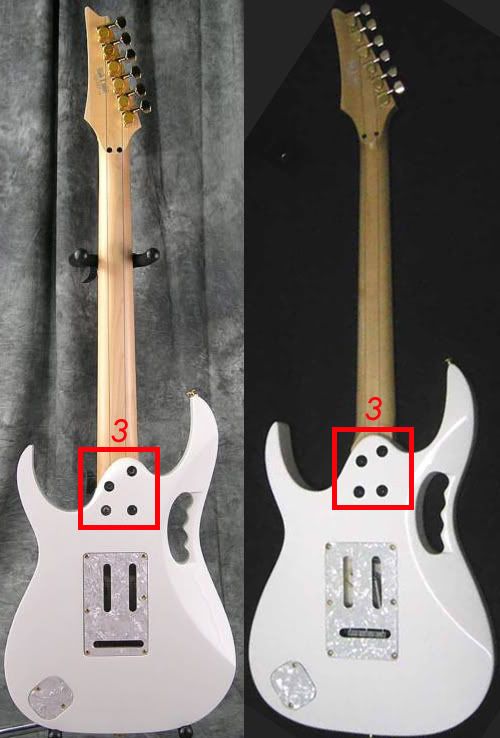

All of the following pictures show the real Ibanez jem on the left, and the Chibanez on the right.

Now, look at the neck screws. First, they're not usually recessed like a real Jem, and the placement is off:
