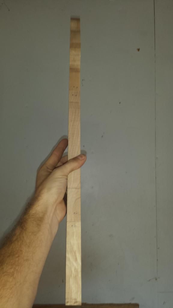

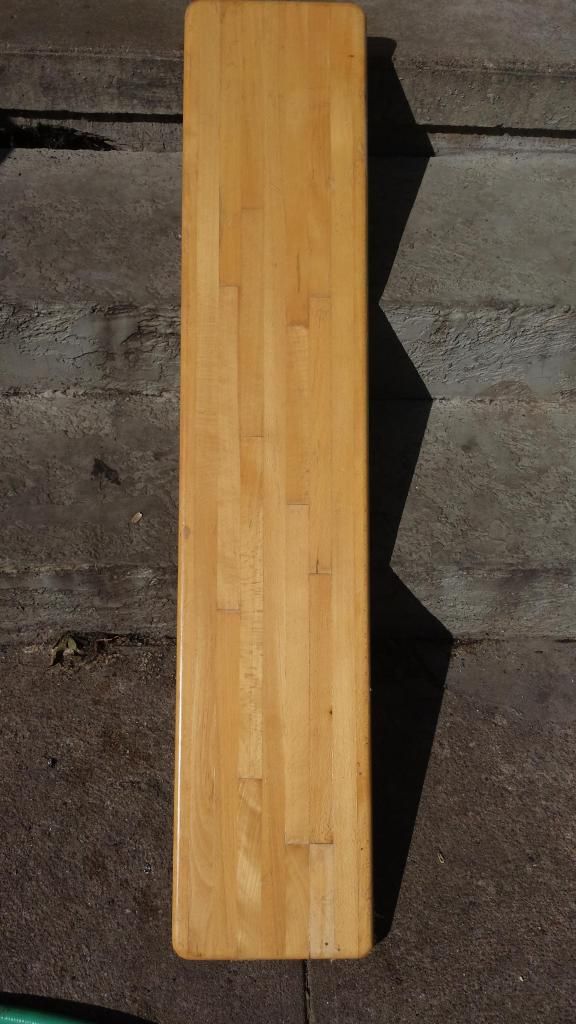

he wants the neck to be made out of an old maple bench he salvaged
I wonder how many asses have sat on this thing
It's dated 1999

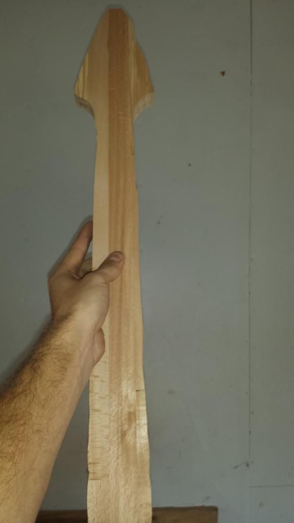

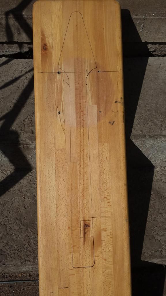

Got the neck outline roughed out

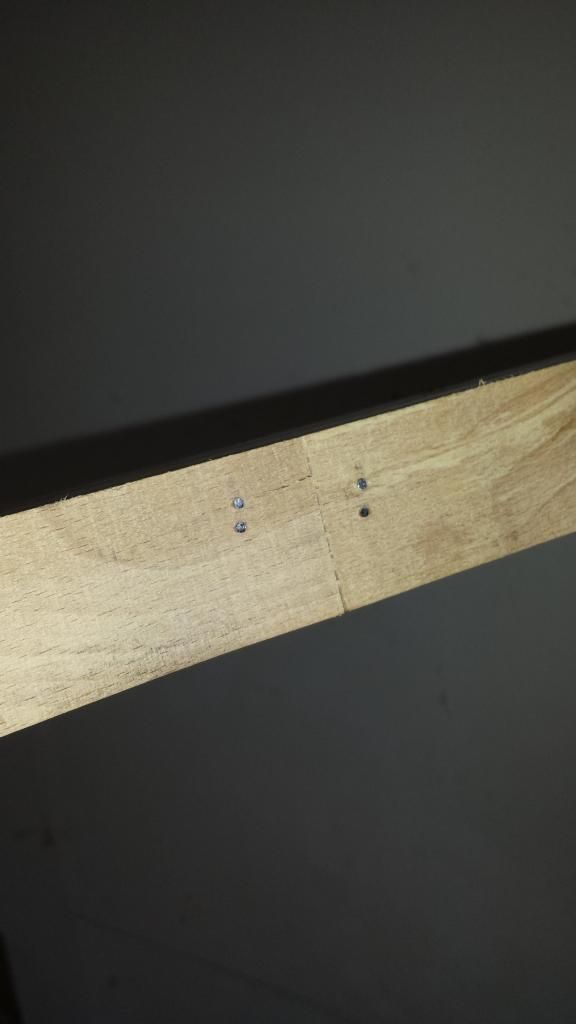

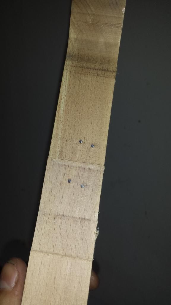

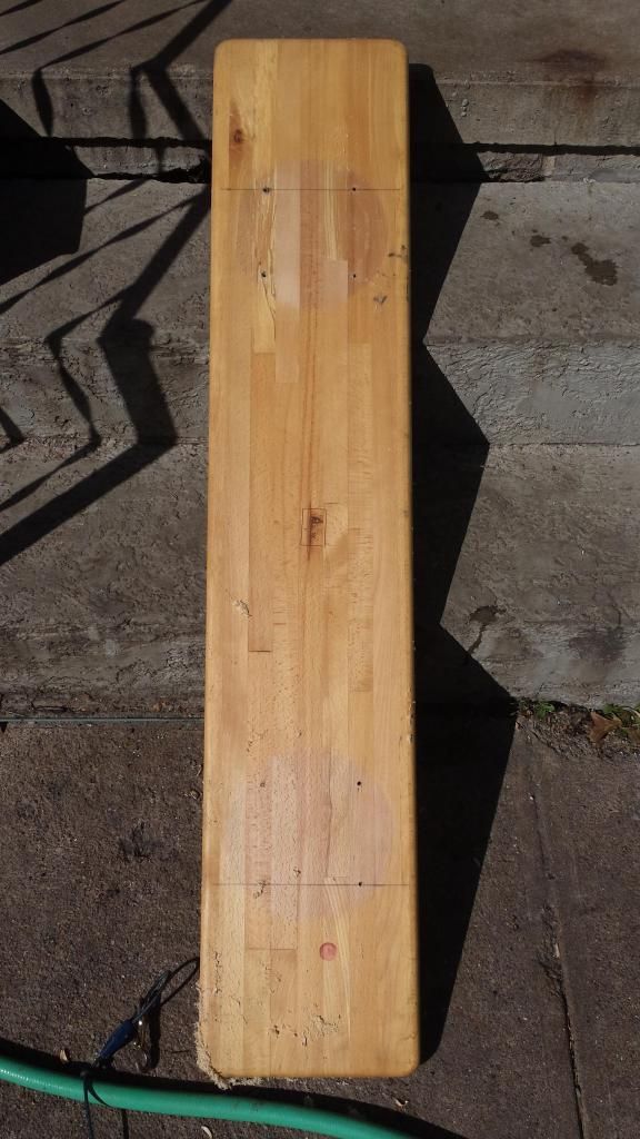

SH*T they nailed it together
I'm going to have to work around these...He did want people to say wtf

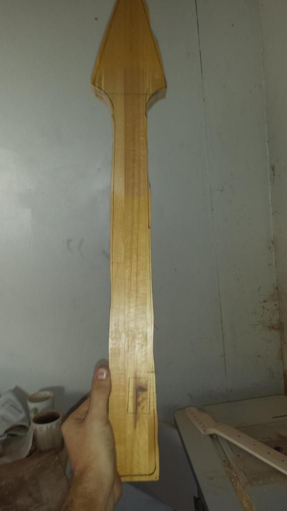

Removed the old finish
thinned it down a lil bit

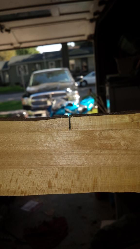

the edges had gaps from when they glued so I sawed them out so i can make a bubinga wedge to fill em up
