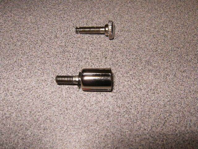

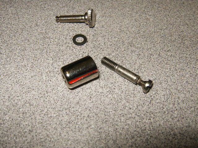

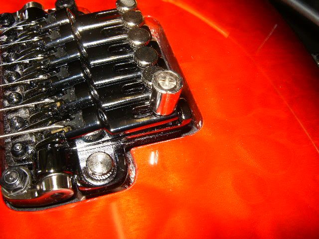

The Downshifter is easy to install. Remove the lower E fine tuner and remove the small washer (be careful not to lose it). Install the small washer on the bottom of the new Downshifter (may not be neccessary but it will keep it safe) screw and thread the Downshifter assembly into where you removed the fine tuner. Tune the guitar. Done. It is not tricky, it is that simple.

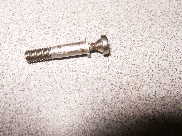

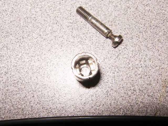

You can use the new barrel to tune the guitar (like a fine tuner) you do not need a screw drive to turn the screw the barrel holds the screw in place. Basically the barrel is notched so that the screw will either ride high or low in the barrel depending on the screws orientation (see photos). So turning the barrel turns the screw.

Downshifter Barrel and screw. Notice the groove inside the barrel, this is where the screw slides in to drop the tuning.
Downshifter screw, note the tabs that slide in the barrel
Washer
Normal fine tuner and assembled Downshifter.
Installed
